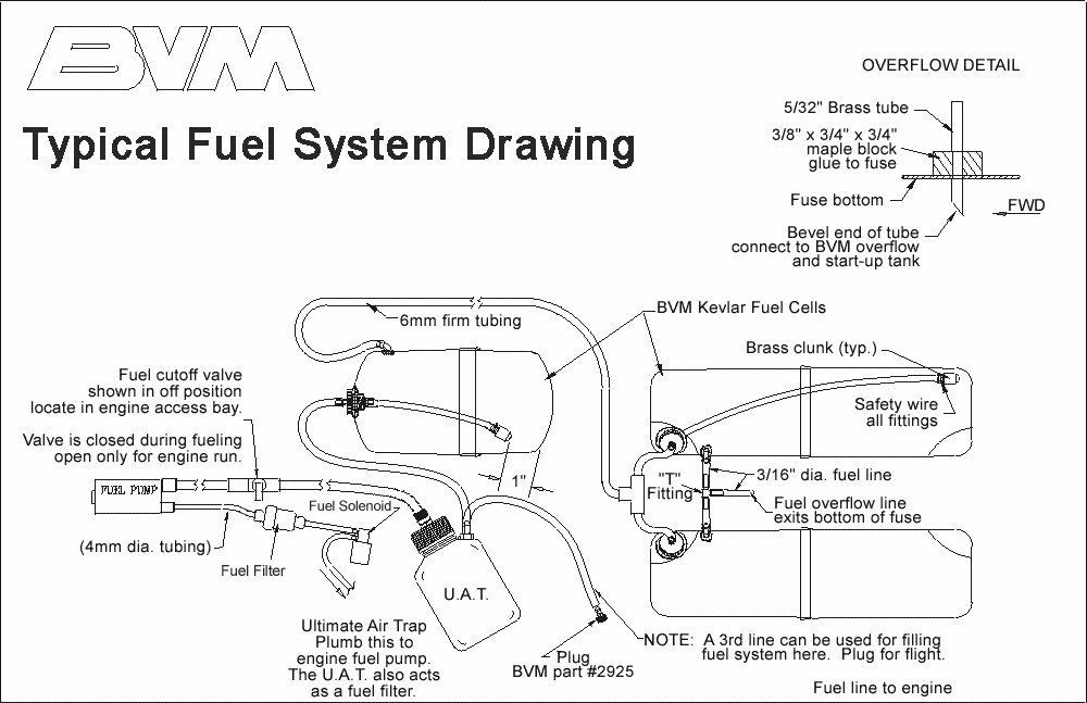

Hi
Could somebody please post some plumbing diagrams and any do's and dont's for installing UAT's with single and multiple tanks?
Am putting my first jet together and am on the steep learning curve :D
Thanks
David
