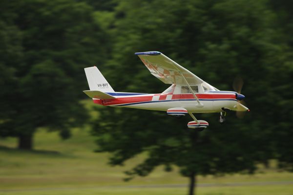

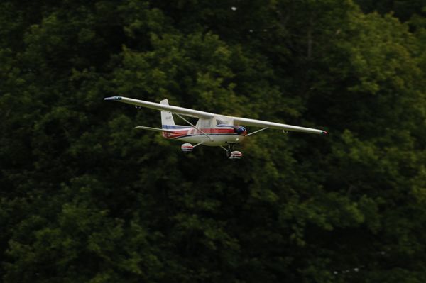

Postby Nigel Cox » June 22nd, 2015, 6:59 pm
Hi Wayne,
Good to see this flying yesterday @ Weston Park :) I'll put some pictures up when I've sorted through them

Postby Wayne Cox » June 22nd, 2015, 9:29 pm
Hi Nigel
Many thanks, she flew very nice am very pleased with the motor going to do some tests on some props.
I put her on the BelAir stand afterwards and she got a lot of interest.
She is hopefully at Cosford and Much Marcle.
Look forward to seeing photos.
Kind Regards
Wayne

Postby Nigel Cox » June 22nd, 2015, 10:04 pm
Here's three to start with.
What happened to the 172/182 in your second slot, that did an inverted pass then all I heard was a sickening Thud !!
Wayne Cox
Posts: 187
Joined: November 2nd, 2011, 9:08 pm
Location: Dudley UK
Re: Wendell Hestetler Cessna 152 30%
Postby Wayne Cox » June 23rd, 2015, 11:02 am
We'll both of us were trying to fly as a pare then Clous split off I was watching the inverted and next thing is we are being asked to land to be honest not sure after that.
Great looking photos can't wait to see others
Regards
Wayne
